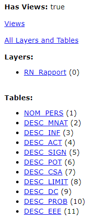

I can see something weird though, the base layer is not populated (0) even if I got a point shape with data into it. There's only the tables which contain have counts. There should have something into RN_Rapport layer...
