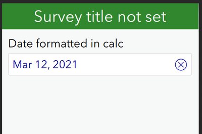

Do your default dates refer to specific dates or are they calculated based on the date the survey is opened? Also, will the survey user need to alter the date at all? One workaround that may work for you is to use the format-date function as a calculation based on a hidden date field. Even then, only abbreviated month names are included (eg Mar as opposed to March):
