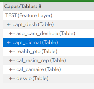

Hi everyone,
I have a survey that worked well in versions prior to 3.13.244 after the update it does not load the survey and the application closes completely.
 This is the scheme of the survey. ¿any ideas?

VerleyAltamirano
I have solved it, apparently the new version does not support the use of "compact w2" in a repeat within a group. I have eliminated this and leave it as compact and with this the application remains.
VerleyAltamirano
Actually, I had made some test in my computer and also it crashed so its not a device issue.
VerleyAltamirano
