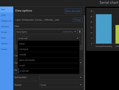

I have a survey that our field workers use to report on their work out in the field. I also have a dashboard set up for the survey to show a breakdown of different categories. I filtered out the 'null' entries for most of my graphics, but a 'blank' category will appear.
When I look at the data itself, instead of 'null' some of the responses are being recorded as blank instead. The Survey uses a lot of 'relevant' questions, so I wonder if that has anything to do with it. I can go in and manually fix this issue, but the survey gets hundreds of responses and I wanted to know if there is a way to prevent this in the first place.

Yes anything not relevant is blank empty string.  Same for questions not filled out.  123 does not have null since that is a Esri thing.  It does convert numbers from blank to null on upload but that is it.  Include blank on your filters.  In AGOL you can use not empty.
Then sometimes when you export the data I have seen null I think but not positive.

For most of the categories in question, I used a choose from list option and because of this I don't have an option to filter out blank answers like I can with null answers because it is technically not an option to choose from. Is there a work around you might know of?

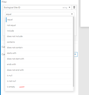

What product is this?  Almost looks like Ops Dashboard?
If you are using a web map as the base then add the filter there of is not empty.  If it is Ops data expressions may work also.

There is not an option to filter "is empty" for the chart.

Have you tried is not equal with a value of '' there?
The new ops dashboard has it but I do not use that either since no relates.

I don't have that option, probably because my data is coded strings instead of a basic string type. It only allows to select from options in its domain/choice list

Ok I see that on coded strings now  It is using the domain list vs looking at the actual data.  That is silly.
Only option I can think of then are use the new Ops Dashboard - see edited post for its list.
