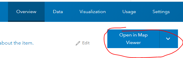

Is there any way to delete a form in a survey? Not the survey itself but forms taken in the survey. IE. I have sample surveys or mistakes in gps locations after submitting forms taken in the field and I want to delete them so as not to clutter up the data. Any info would be appreciated.
KassandraRodriguez
Go to either portal or ArcGIS Online account under the username you used to create the survey. You'll find the folder you named the form and click the feature layer (hosted). Open it up in Map Viewer and click the point you want to delete, there's no need to save the map just exit out.
P.S make sure editing capabilities are enabled for the form under settings
by Anonymous User
Not applicable
Perfect this is what I needed.
