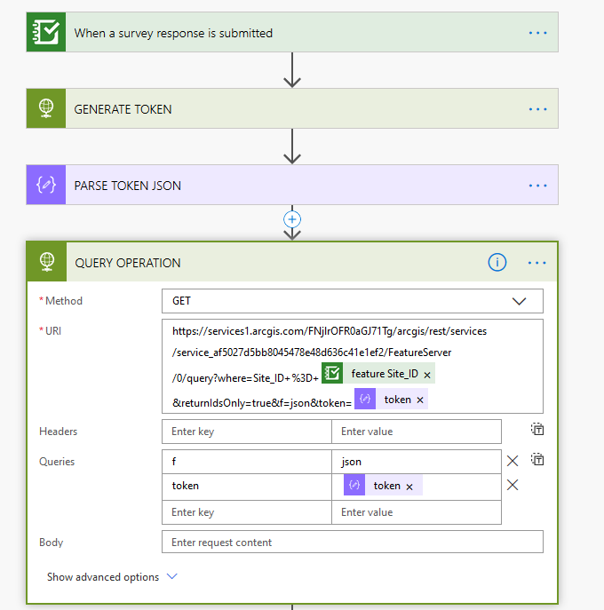

Did you ever get this workflow to work? I am also confused about the HTTP Request component.

Please review Update Features—ArcGIS REST API: Services Directory | ArcGIS for Developers  - I mentioned specifically that the request shown in the screenshot was missing some required parameters:
f=json - the format you want to receive the response in
token=<TOKEN> - the token that allows the request to access secured services.

It appears you're prematurely percent-encoding the '=' to %3D - Power Automate will take care of that for you

I removed the percent-encoding but the same error is persisting.... the status code in power automate is 200 when it runs but the error code can be found in the body of the http query operation. Any help would be appreciated!

I would also remove all of the parameters from the URL, placing them in the queries section - if Powerr Automate isn't autofilling the URI based on the queries, you are sending the 2 f and token parameters.

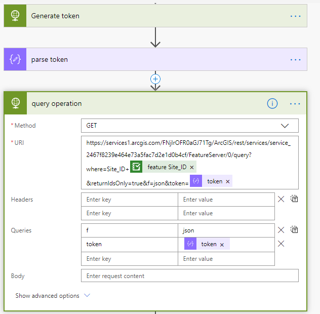

Thanks for the response. I removed the URL parameters but it still returns the same error code 400. The URI shown in the screenshot  is copied below as well, I believe the percent encoding may be necessary but I'm not sure.
https://services1.arcgis.com/FNjlrOFR0aGJ71Tg/arcgis/rest/services/service_2467f8239e464e73a5fac7d2e1d0b4cf/FeatureServer/0/query?where=Site_ID+@{triggerBody()?['feature']?['attributes']?['Site_ID']}

Hi Chris,
Again, could you move all of the parameters (including where) to the queries (and remove the ? as well)?
