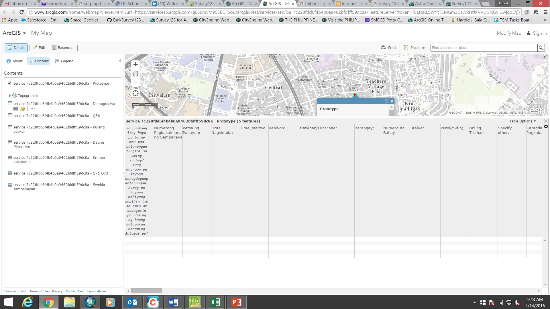

Hi Survey 123 team,
Congrats on your recent Survey 123 update, it significantly boost the loading performance of the forms.
We just encountered something that we want to confirm.
We viewed the results of our survey in the map viewer and click show related table. Unfortunately, the attributes of the related table doesn't show: the attributes of the related table only displays when we click their "show table."
IsmaelChivite
Esri Notable Contributor
Hi,
thanks for reporting this issue. This problem has been fixed in the 1.2.89 version of the Survey123 mobile app. If you install the app with the latest from the app store, this problem should go away. Find more details here: 1.2.89: Critical Update to the Survey123 mobile app   With the new mobile app, you will see the related record information populated when you capture new data.
