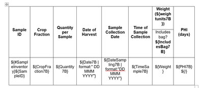

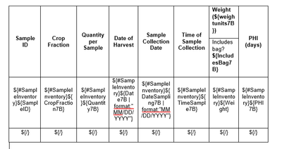

I am trying to get the info from a repeat table to populate a table but either it creates a separate table for each entry or add a blank row between entries. Has anyone found a solution to this problem?
JessicaStoeckli
I figured it out if anyone is interested: The repeat is opened in the first column with the repeat table name and closed on the last column with ${\} - see below.
