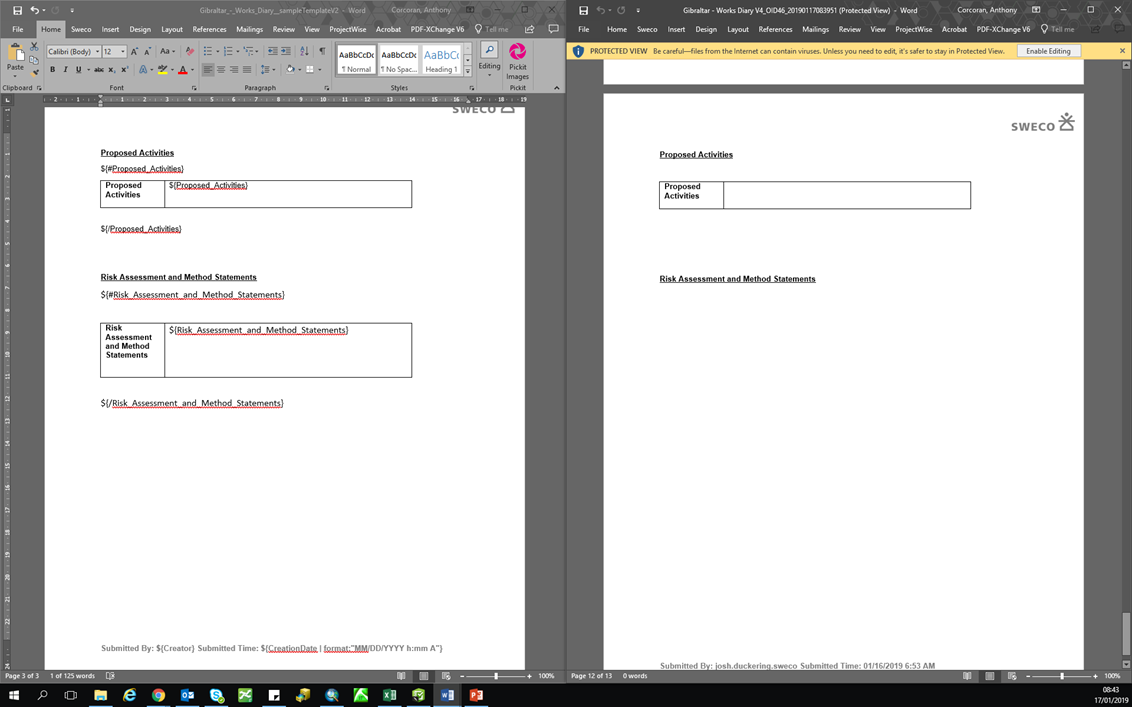

Survey 123 report template not reading survey value syntax,
For reason i cannot figure out the Risk assessment section below will not pull through.
The survey has multiple repeating sections.
If i remove the repeat, the template will display (object, Object) in place to the value.
Any help would be appreciated!
Jim-Moore
Hi Anthony
Thanks for the screenshot. To show a repeat in a table, the repeat start and repeat end expressions should be placed inside the table (with the repeat's questions in-between). Please see https://community.esri.com/groups/survey123/blog/2017/07/26/introducing-custom-form-report-templates... for more handy info (Tip 6: Working with Repeats):
If you want to print repeated records within a table, put the expression ${#repeatname} in the first cell of the repeated section and the expression ${/repeatname} in the last cell of the repeated section.
