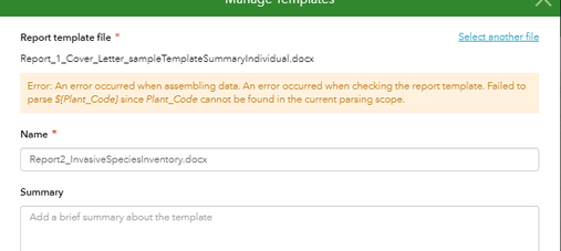

Hi There, I receive the same error when I upload a custom report template into Survey123 , please see error below:
I have no repeats in my form and my field names are exactly the same in my report template as they are in my form/feature service.
My report template is very simple and just contains a table within a summary. When I do not include the summary within the report, I do not receive the error but when I do include the summary I receive the error.
Am I missing something? Have I not included the summary notation correctly?
Please find attached a copy of the excel  form and the word report template.
Any help would be greatly appreciated!
Thanks!

I'm getting the same error.  If I delete the offending field from the template, the error just moves on to the next field.  All fields are within the repeat table.
This is by far the simplest template I'm attempting to publish, so I'd like to get this issues resolved before driving myself crazy with the others.
