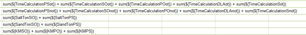

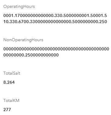

Another issue that I'm having is that at the end have a calculation of the repeated input, in this case is the sum of all the "Operationg Hours" and "Non operating hours". The formula is not showing the calculation how it's supposed to.
Formulas
Generate those calculations, see that the "TotalSalt" and "TotalKM" are showing properly but not the first two.
Please if you can help me by telling me what I'm doing wrong.
Thanks.

Looking at the second question, it appears that the sum() function concatenated values instead of adding numbers to gather.  Are any of the fields being summed text, note, hidden, or calculate?  If so, you need to set the bind:type XLS column to the appropriate data type so that the form will process them correctly.

In the matter of the second question. Those fields are calculated fields, not stored as a text. See link to view the survey (Survey CAAM)

On the other questions, calculate questions are treated as text - even if they used a numeric calculation to be populated, when accessed by other questions, text processing is used.  You will need to set the bind::type column to either integer or decimal for the sum() to work properly.

In the other question, I see the column bind::type in the excel, but what do you mean with set that column to integer or decimal?
Do I need to type in the formula over there? or just adding the int(formula) in the calculation cell?

The bind::type field sets the type of data when used in calculations in the form; the primary reason to use it if you have a text/note/calculate/hidden that contains numeric data.  You should see a dropdown for that field - the range is a little off (it'll be corrected in the next release), but you should be able to select 'int' or 'decimal' as the value.
