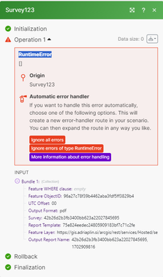

Hi,
i am trying to generate pdf reports when new record is submitted, but i am getting error on report generator (Runtime error). Is there any way to extend the runtime before it hits the error?
Has anyone els same issue?
2 Solutions
ZacharySutherby

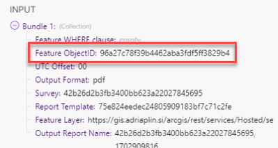

Hello @MihaRobar
Based on the screen capture it looks like the features Global ID is being passed into the object ID input
Try changing the dynamic input to use the object ID instead of the global ID. Please see this documentation for more information: https://www.make.com/en/help/app/survey123

MihaRobar
Hello @ZacharySutherby Thanks again for your answer. Now it woorks for me. I had to use objectID from the result.
