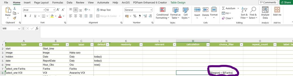

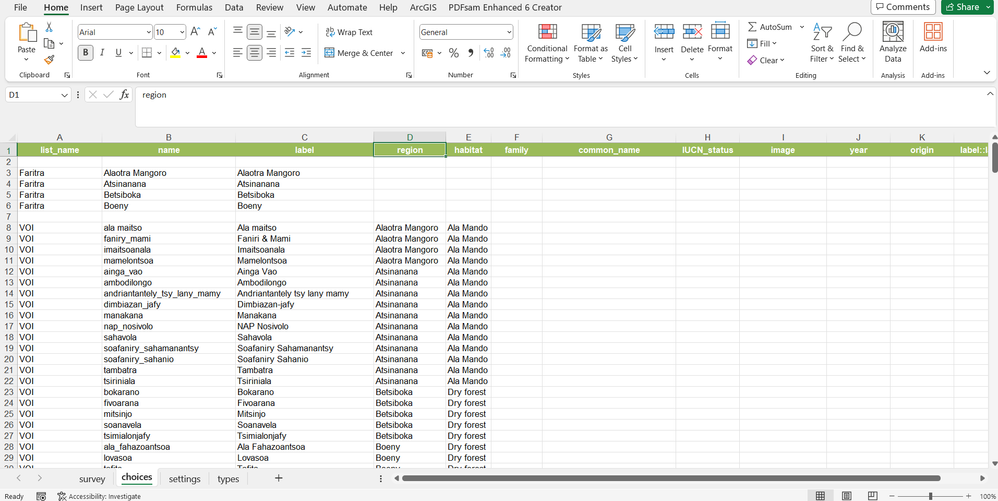

I am having the same error message.
There has been problem trying to replace ${region} with the XPath to the survey element 'region'. There is no survey element with this name
The text highlighted in purple is the problem, because in my result, I wanted to have just one column of Faritra (if I put region = ${Faritra}, I got 4 columns as I have 4 different regions) while when displaying the survey, I wanted to limit the list of VOI shown into those VOI who are related to the Faritra selected.
Thank you
