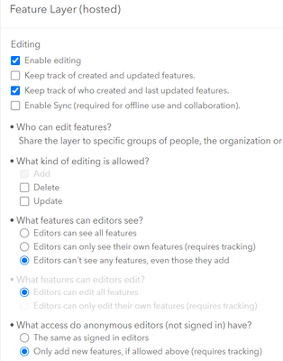

ZacharySutherby
What you could do on the settings of the hosted feature layer created in ArcGIS Online is set the permissions so that editors cant see any features and can only add new features. This will disable query on the REST endpoint of the feature service.
