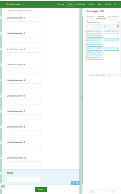

Hello,
I am currently trying to have survey123 auto compile structure totals for our projects during the year. I have 10 different structure types that I would like to have their totals housed in one location. I did this by adding another "number" column and then using the calculation function to add them all together. The issue occurs that only 6 of structure types show up no matter which ones are selected. I thought maybe 6 was the limit so I added another "number" function to add the other structures to and figured I could add my two totals together for one final total and it still gave me the same issue. Is there a limit on what can be calculated? Any insight would be helpful!

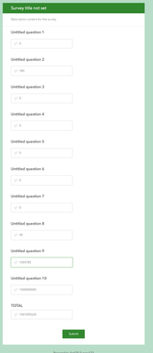

Well, I am using the online webapp to make the survey, so im not sure about the spreadsheet. I'll attach the screenshots from before and after hitting okay.

Hi @JJZielinski - I don't know if I fully understand, but in ArcGIS Enterprise 11.3, I was able to:
  1. create a new survey in the web designer
  2. add 10 number fields - set the default value to zero if you want the total to calculate as numbers are entered
  3. add 1 total field at the end, which was a sum of all 10 fields above it
  4. save and preview/test
was this survey created initially in the web designer?  do you know what version of ArcGIS Enterprise you have?  I have no idea if this is causing issues, but can you try after renaming the questions to not start with a "#" (maybe use "No. or "Number" instead).
