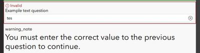

If the answers are going to be the same every time, here is what you can do. Create your question in Survey123, and then add a constraint to it. The constraint will prevent the survey from sending unless it meets the criteria of the constraint. And then you can also include a constraint message that will tell the user if the answer is not correct.
I attached a screenshot example below. For this one, there is a constraint of .="test" meaning that it will only submit the survey if the user inputs test in the question. If they enter anything else, there is a constraint message stating that. Note that for text responses, the text value needs to be in quotes in the constraint.
MeganHomison
Thank you! I tried this out and it works!

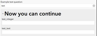

RyanUthoff has a good solution. I'd approach it slightly differently, by constructing a hidden group that only becomes visible when the correct answer is provided. This makes it clearer to the user what is expected.
Either solution works.
MeganHomison
Thank you! I like the look of this!
