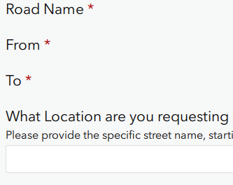

I am using survey 123 connect to publish my survey. When I change the questions to "read-only" the white input box disappears. Has anyone encountered this issue? How can I resolve this?
Please see the attachement, you'll notice the box is missing from the first three questions.

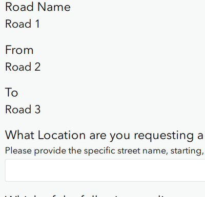

Nope. No greyed out box. Honestly, I also wish it was there as that would just look nicer.
... all that said, I put a little more thought into this, and may actually have a solution/workaround!
Use a multiline text field, set it to readonly, and specify a height:
aam
haha that's great. It's funny cause I did play with the multiline option but wasn't sure about the height settings. Good to know and thank you!
