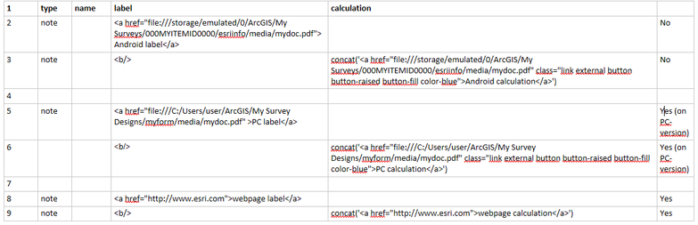

I am having trouble with this. I have the same goal as the original poster, to include help documentation to be viewed in an offline situation.
I have tried several different options as what you see in the table below. Rows 2 and 3 has links to the local files on my Android device which is essentially what I need. Neither works though, there is no response from the app when clicking the links.
Rows 5 and 6 reference local files on my PC and work on the PC but not in the field-app for obvious reasons. Same as for the links for to the pdf stored on the device, nothing happens when clicking the in the field-app.
Rows 8 and 9 both work.
I have verified the location on my device (with the correct item-id) and that the .pdf is present on the device after downloading the survey.
Seems there is something wrong with how I reference the local file on the device, in this statement:
<a href="file:///storage/emulated/0/ArcGIS/My Surveys/000MYITEMID0000/esriinfo/media/mydoc.pdf">Android label</a>
What am I missing, can anyone give some input?
