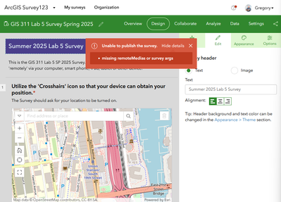

GregoryLund2
I'm having the same issue, but due to changes in the way surveys are 'made' in Survey123, these solutions do not work for me.
missing remoteMedias or survey args
