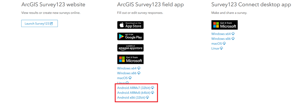

ArthurXiao
@ZhifangWang
Hi, we have friends in China want to install Survey123 app, but as you said Google Play is blocked in China. So do you know where to find the .apk file for Survey123 app?
Thanks!
IsmaelChivite
Esri Notable Contributor
Hi @ArthurXiao  You can download the apk directly from the Survey123 resources page
ArthurXiao
@IsmaelChivite Thank you very much for the quick response, just checked, after download those .exe files, run it, then will get .apk files. Great!
