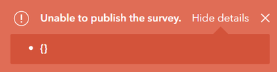

Hi there - I am unable to publish changes to responses on Survey123 web version (this survey has never been in Connect).  I had two typos and corrected the misspellings in one of my multiple choice questions.  The error simply provides {}.  I don't quite find this useful.
The survey is active and responses have been collected.  Is this possibly the problem - I can't update responses due to collected data already being present?
Any other insight or workarounds for me to correct the typos and be able to re-publish the survey would be much appreciated.  Thanks!!

Thanks!  What I finally tracked down was this was related to the choice list.  I had typos in the choice list, and because data was already populated on that question with the choice, I was unable to update/publish the survey because it didn't recognize either 1.) my updated choice, or 2.) it was looking for the already popluated choices.  I lived with this shame of the typos (hah!), but learned a couple valuable lessons along the way.
