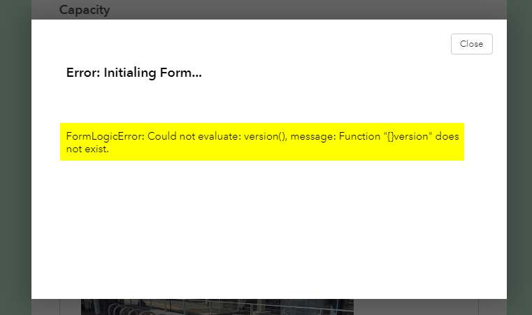

For debugging purposes I add a string field called FORM_VERSION to my surveys that pulls the form version number found on the settings tab. I increase one of the version numbers each time I make a substantive change to the form and want to differentiate results between versions (e.g., when adding a new field, I can quickly identify why certain rows have nulls).
Pulling the form version is easy in Survey123. Just add version() to the calculation column of the XLS form.
The Survey123 mobile/desktop apps support this. The Survey123 web form does not support the version() calculation. Can support for this calculation be added to the web app?

Hi Elliott,
Currently, the version() function does not work i the web form.  I've added this thread to the enhancement issue to implement version() in the web form.
