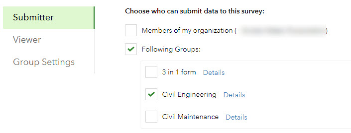

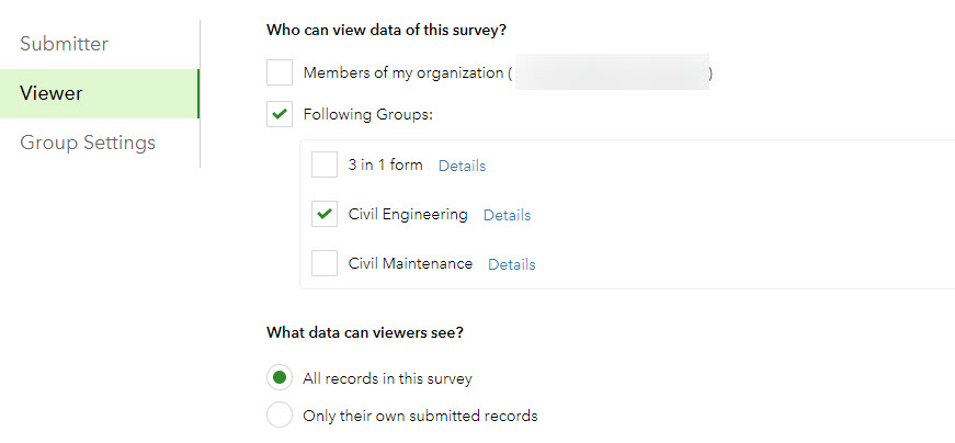

I have checked the permissions and they seem OK as below:
