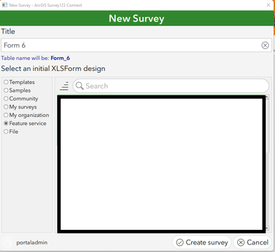

I would do it the other way - in Connect, choose to create a new survey and then choose "Feature Service" - the submission url and form id settings will be populated for you.

Thanks @DeonLengton ! It works!
