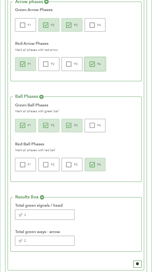

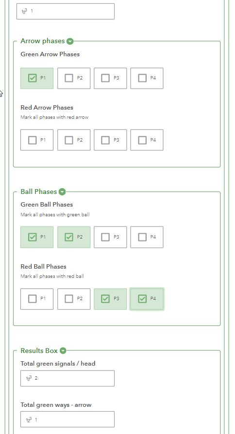

Now, on the web app interface, the first repeat selections produce correct results in result box. The problem happens when I add a new repeat:
  • Both repeats calculations are reset to zero.
  • when the second repeat selections are set, whatever the result is, it gets posted to the first repeat’s results box instead of the second !!!
Here is a test case
1: Set the first repeat with result : 2 , 1
2: Set second repeat with result : 3, 2

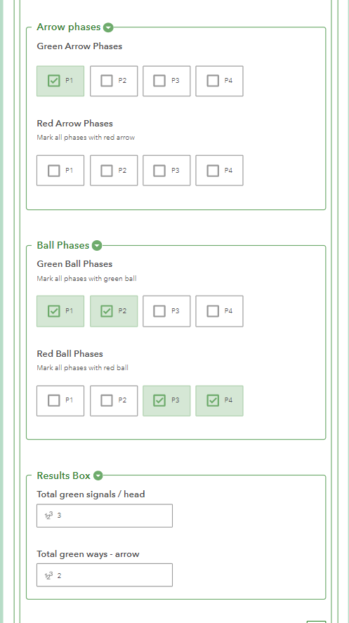

3: Check first repeat again: result is incorrectly changed to 3, 2 (as second repeat's result)
It seems that the first repeat takes question values from the last repeat some how !!.

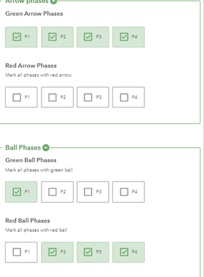

yes it would be way easier to use count-selected. However, I can't just count selections, I need to know which phases are selected (P1,.. P4) at each questions. The goal is to count the number of green signals and green arrow. A green signal is counted if there is green ball or a green arrow without red ball at the same phase.
In the Image below, there is only one green signal because only P1 (phase 1) satisfies the condition.

When I replaced selected-at() with contains() and did the proper modifications, the problem persisted (adding new repeats after the first miss up calculations in the first one - on web interface only). However I could use your advice to solve the problem as follows.
1- Removed relevance conditions from some calculated fields which results are based off of.
2- Changed the P1- P20 calculated fields types from "calculated" to "text" with appearance  = "hidden".
Those two modifications did it and when I change any back, the problem comes back !!.
Attached the last modified document,
