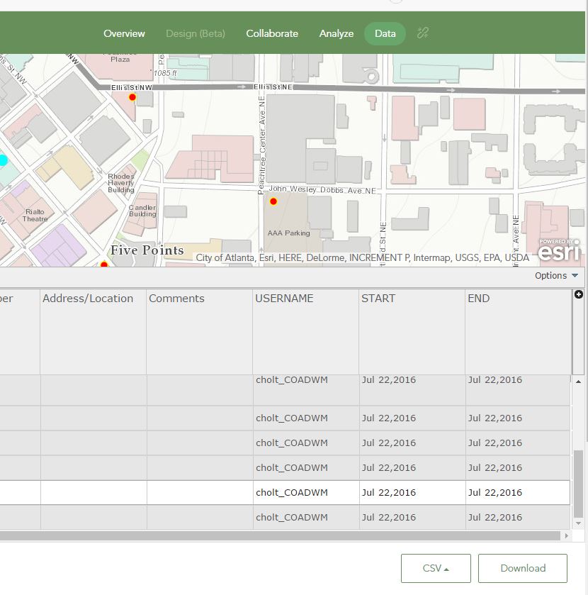

Using the start and end field types to capture more accurate times, but only the date shows up.

Hi,
  you can have a look at the time if you configure the popup in a Web Map. Have a look at the Dates and Time in Survey123 for ArcGIS | GeoNet blog post, towards the end of the post there is an explanation of how to display the time.
  Hope it helps,
