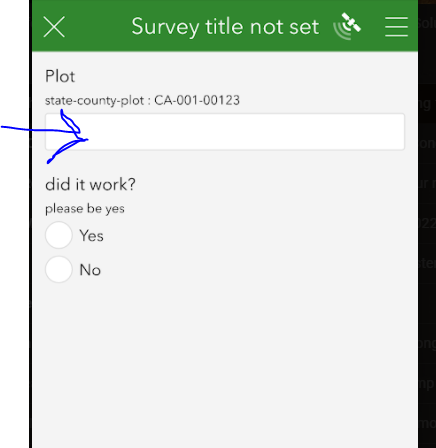

From survey123:
From AGOL:

Okay figured it out.
My original URL scheme was correct.
I checked other forums and it really is an '&'
arcgis-survey123://?itemID=7f0e5eb93d424c1ea532da3d684c6a75&field:plot={st-cty-plt}
The problem is that it does not like "-" in st-cty-plt  even though that is what it says in the attribute table in ArcPro and on AGOL. When I used {st_cty_plt} it worked.
