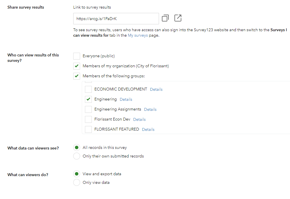

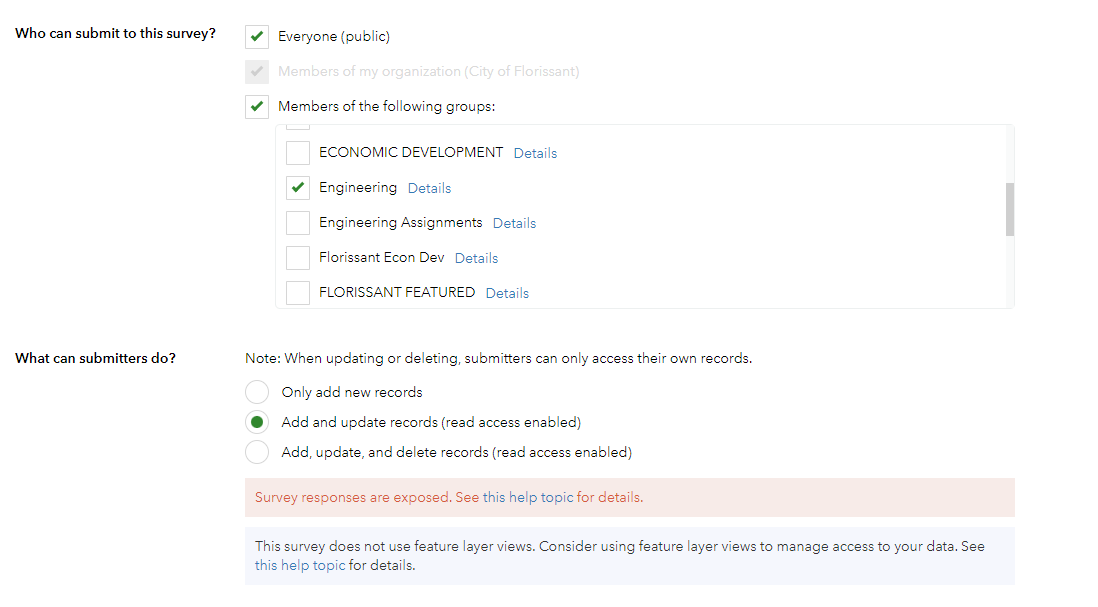

This survey is shared with Everyone (public), members of an Engineering group, and members of the ROW Excavation Manager group.
I also have allowed the ability to update records.

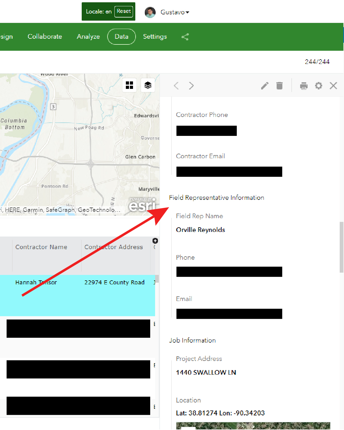

I am having issues with members of my organization not seeing all the attribute data in their feature reports or rather seeing blanks where data is present.
Specifically these fields:
  • Representing Organization Name -- This is a text question.
  • Applicant Role -- This is a select one type question.
  • Field Rep Name, Phone, Email -- These are text questions.
  • Owner Name, Phone, Email -- These are text questions.
The odd thing is that when I pull these reports the data is all there and these fields are viewable from the right-hand 'Form view' --see screenshot below. I noticed that these fields were missing in the slide from another member's list of attributes on their 'Form view', but when they go to edit the form the fields are there for editing. Once they close the Form view edit the attributes are still not present.

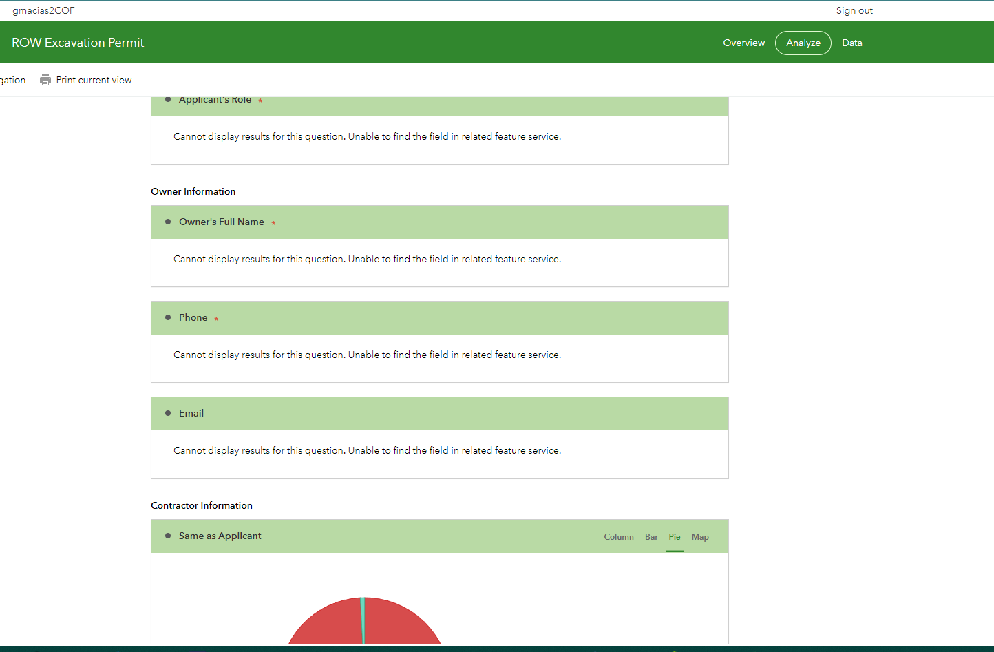

I have confirmed the members with share results access are in the group. The link that is shared will take the user to the analysis view and the attributes specified above with issues are showing this error message:
Cannot display results for this question. Unable to find the field in related feature service.

For the one field role that is a reserved word so that could cause it.  Also type is a reserved word.  It seems like you may have done a Ctrl V vs right click paste values.  That will mess up all the validation so then you will not see these green errors.  May want to start a new form now and paste in values to fix all that.  There is a post I have out there with directions somewhere.
See the green errors
Looks like the owner info has a calc using the role field which could cause your issue.
