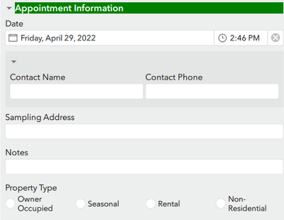

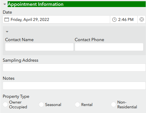

Hi all! I'm creating a survey in an xlsform (B) in Survey123 Connect, tablet portrait form factor. I have a group of questions where I want some questions to appear on a line by themselves, and others in 2 columns. I can accomplish this by putting the 2 column questions in their own nested group within the main group.

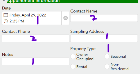

However, this slightly indents the 2 questions and more importantly, allows the nested group to be collapsed, which I don't want (C). Otherwise, whatever I try results in all questions appearing in two columns (A). Is it possible to accomplish this, and if so, how? Thanks.
(numbers indicate desired # of columns)

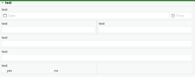

Seems strange because it works on my end as you can see in the screenshot I shared. Would you be willing to share you xlsform file?

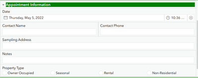

JeremieCote
It should works now.
Works on my end.
