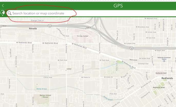

I think the best and easiest way is just type them into the map.  That way the map is correct and it all just works.
