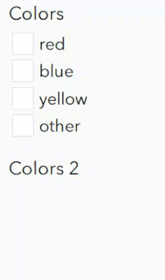

I am in a situation where I want the choices selection in Question 1 (only the selected choices) to be
re-used in Question 2. Any suggestion or hint would be greatly appreciated.

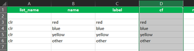

Set up your list so that each choice's name value also appears in a choice filter column.
Now we need to set up the actual choice filter for Question 2. Question 1 is a Select Multiple, which means the selected choices will be stored in a comma separated string such as red,yellow,blue. So the choice filter needs to be able to parse the stored answer to look for each choice's filter value.
contains(${q1}, cf)
If the Question 1 response contains our choice filter value it will display the value.

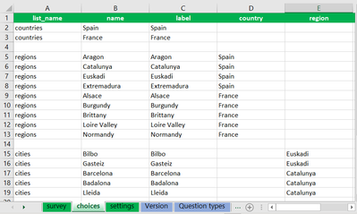

if C1_eco is the first question, the choice filter on question_2 should say
selected-at(${C1_eco}, filter)
Where filter is the name of the filter column you have added to your choices list. It can be a copy of the list.
e.g. here the filters are 'country' and 'region'. you could try the same but your filter would be 'city' and it'd be a direct copy of the list, a one to one match.
so add a column called 'eco_filter', copy the names from the list into it, then have your choice filter on the second question be selected-at(${C1_eco}, eco_filter)
