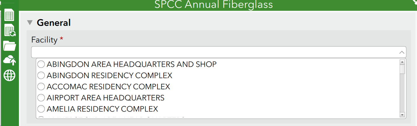

When I open the survey in Survey123 Connect, the dropdown for the question works normally.

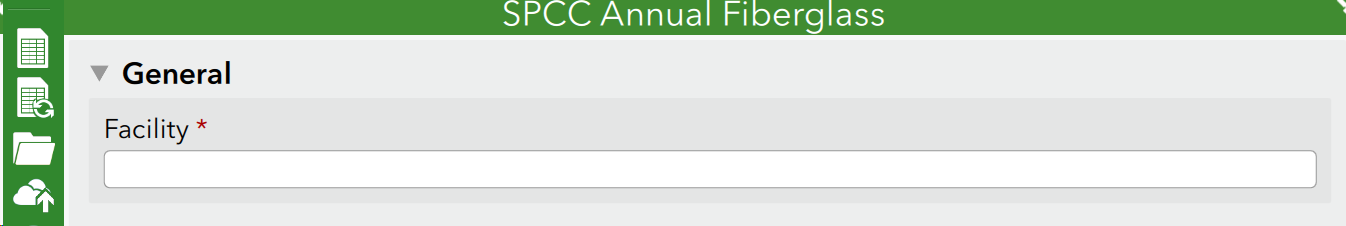

However, if I go into itemsets.csv in the media folder and make any modification to the csv, such as deleting a row, the dropdown breaks (I leave the csv open on refresh so it won't be overwritten by Connect on refresh).

Update on this question. Adding a hidden question to serve as a placeholder for filtering a select_one_external is the right approach; however, there are some pitfalls that can occur when updating the itemsets.csv which  will cause the select_one_external dropdown to not load. This is only occurring in the native application, no issues on the web app. To inspect how the csv is storing the values, use a text editor instead of excel. Here are two options for getting the filter to work:
  1. Quote all non-numeric columns in itemsets.csv. When modifying the data from excel and saving as a csv or by doing it programmatically with python, the default export settings does not wrap quotes around data elements. When Survey123 connect exports the itemsets.csv it wraps the _EXTERNAL data elements as _” but when modified from excel or python the value ends up as unquoted. This can easily have modified and solve the issue as follows:
