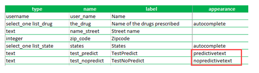

It may only work for Android but try this setting to turn it off.
In the published survey, the predictive text is displayed for the question with a predictivetext appearance (image on the left) and not displayed for the question with a nopredictivetext appearance (image on the right) on an Android device.
From https://support.esri.com/en-us/knowledge-base/how-to-set-consistent-formatting-and-spelling-for-resp...
Hopefully that does it.
EricPetersen
Thanks for the response! This doesn't do it, however. "predictivetext" and "nopredictivetext" apply to text type fields only; I'm using a "select_one_from_file" type field. I also understand that the predictivetext appearance options apply only to using the form within the Field app; I intend this survey for use on mobile browsers on devices used by the public.
