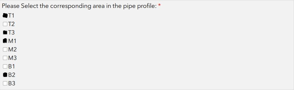

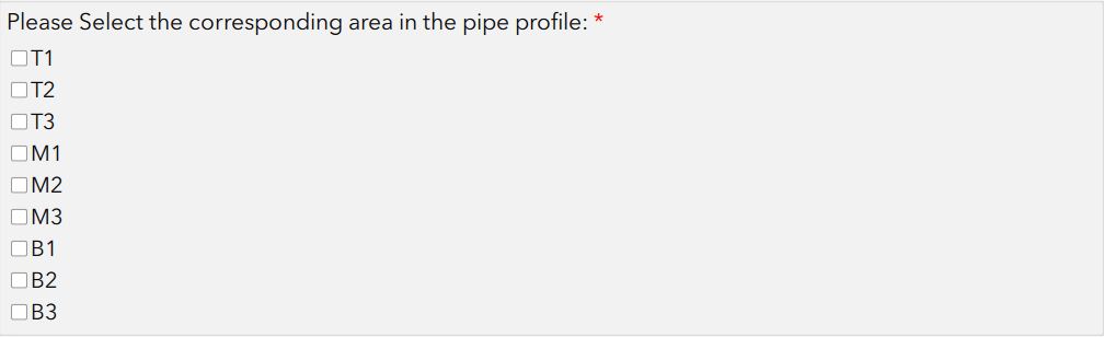

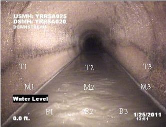

I am creating a Flow Monitoring Field Maintenance Log for data collected on various pipes. There are several different regions in the pipe a user can select from a list, and from there, depending on which pipe areas they chose, the
corresponding discharge "D" values will appear.
For example, a user can select regions "T1, T3, M1, and B2", doing this will make the corresponding text boxes appear for only those choices. It would look something like this.
T1_D __________
T3_D __________
M1_D __________
B2_D __________
I have read up on the article "The Art of Hiding, https://community.esri.com/groups/survey123/blog/2016/05/28/the-art-of-hiding , and used every suggestion listed, but nothing seemed to have work.
I have tried selected(${select_multiple}, '1') OR selected (${select_multiple}, '2') ,(I repeat this step 7 more times)
and I have replace the OR in the previous line with AND, still no progress. The selected option seems to keep the field it is attached to visible at all times on the survey, but I want the "_D" fields to be invisible until selected by the user.
