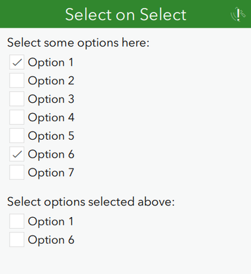

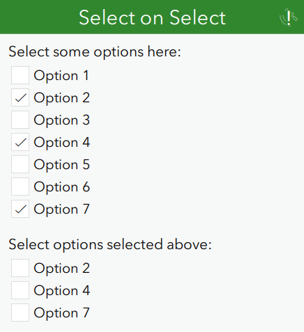

I would like to base a select_multiple based of a previous select_multiple. When I make selections in my first select_multiple, the second select_multiple must be updated with what is selected in my first select_multiple.
I am using ArcGIS Survey123 Connect.
Example 1:
Example 2:
Thanks for any help on this.

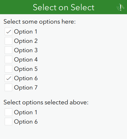

ZacharySutherby
Hello @julian_svcs
select_multiple stores it's values as a comma separated list so what you can do is place ${select_some_options} in the calculate column for the Select options selected above question and because it will receive the list from the previous question those same choices will be selected in the second list.
Thank you,
Zach
