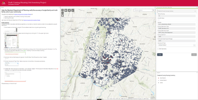

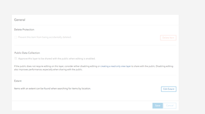

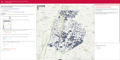

I cannot believe that ESRI still has not come up with a good solution for a crowd-sourced map application. I used ArcGIS Web App Builder, then created a dashboard theme, then used an "About" widget to provide instructions, then the "Smart editor" (which for some reason, I can no longer find in the widget choices) so that users can click on a point location and then edit certain fields. The web map and any layers you want the public to edit must have "Public data collection" enabled in the options menu.
Here is a screenshot of the application:
