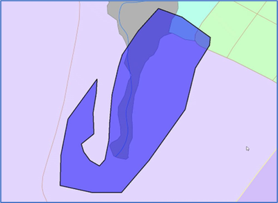

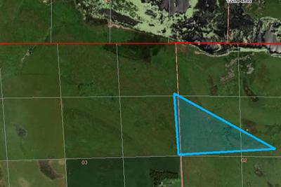

In the Survey123 app I draw a shape
I then hit the check mark. If I now use my finger to move around the map (not the shape I drew), the shape shifts location
After submitting the form, the polygon shifts again, the red being what was submitted originally, and the blue being the polygon available for update in the s123 app.

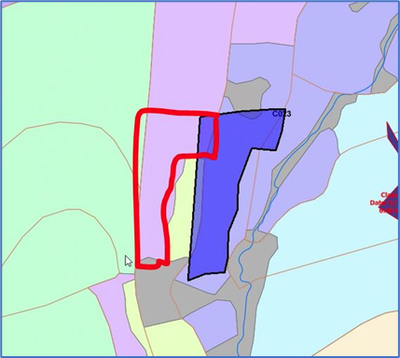

@IanGallo, the problem at the time when I posted it was resolved with an update to survey123 3.12**, however, I have recently had users complaining about the same behaviour happening again. I haven't been able to replicate the error on my side, but of our users are definitely having a problem, as shown below (the red line is where the polygon should have been).
Mondi_GIS_0-1660633027371.pngMondi_GIS_0-1660633027371.pngMondi_GIS_1-1660633047974.pngMondi_GIS_1-1660633047974.png
Mondi_GIS
I have had similar issues with the geometry shifting between when it is captured and then I accept the geometry and it shifts when we accept it.
