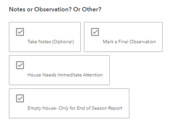

To contribute to this, I've done more testing and this appears to affect more question types than we previously thought:
Select Multiple have the appearance of being already checked (!?) the xls form has no other settings on:
DanteLee
Here to chime in with the same issue! Luckily previous versions are still intact.
