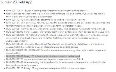

This bug is fixed with Survey123 version 3.13 right? This is what I understand from the following post Survey not sending using callback
TheFletch
Yes version 3.13 has fixed this bug
