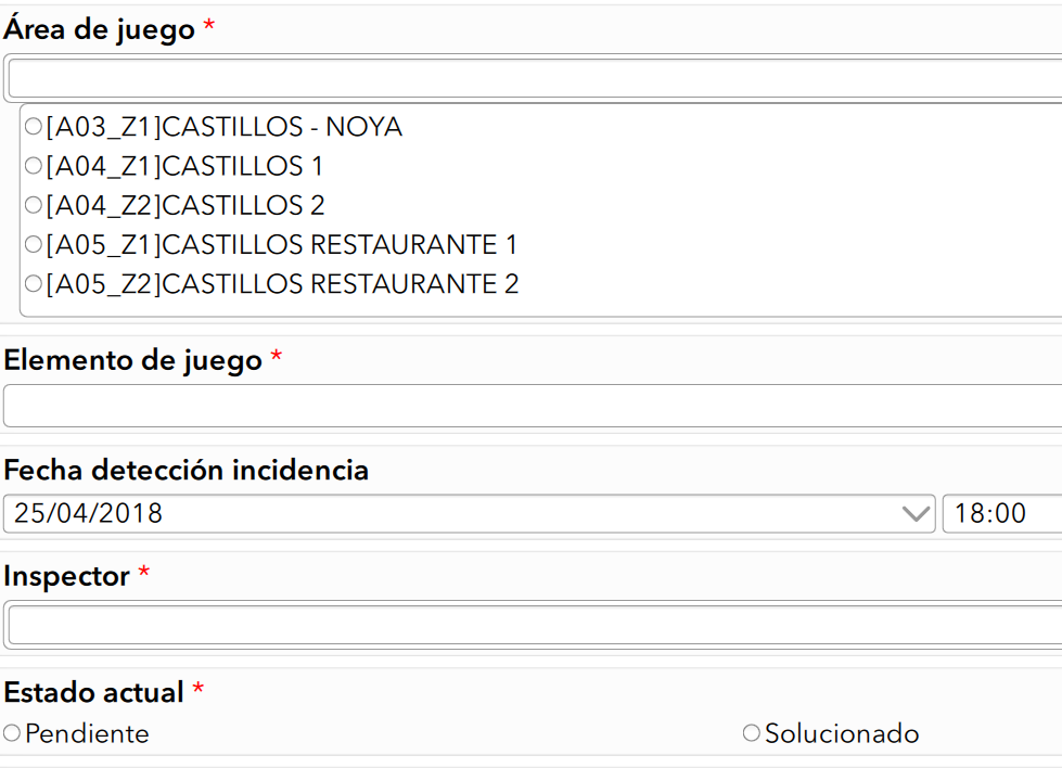

Hi everyone,
Would it be possible to restrict the survey to just 1 form for each feature ( 1 ID = 1 form). For instance, not being able to choose the same area (A03_Z1) once it has been previously populated.

Hi Gabriel,
This could be done if you create empty records (one for each feature) for the features beforehand and use the Inbox to have this be an editing workflow.  Otherwise, as Renato mentioned, this would need to have a search() function (extended to scan either the feature service or possibly the user's sent folder), which is currently not in Survey123.
