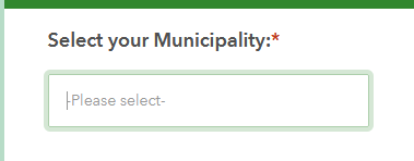

Hello. I have a survey that helps our emergency management agency identify the status of the 37 municipalities in our county. It's pretty simple. A municipality first chooses their municipality from a drop down list.

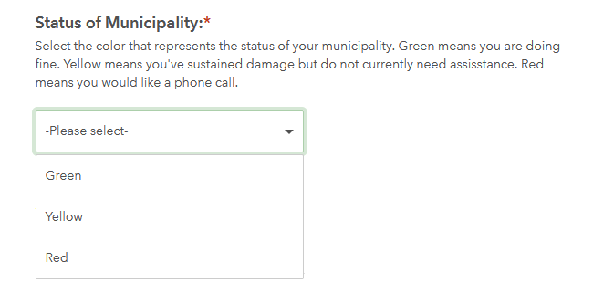

Then they choose a color that best describes their status from another drop down list. They have 3 choices – green, yellow, or red.
