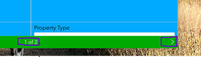

They should be able to click through, or click the page number, in the footer area.  You may also want to reconsider the order of your pages or questions, if possible, if answers depend on one farther along.

What platform, field app or web app are they using.  If the field app, then as @ZenMasterZeke said, you can move to any page without filling out required questions.
