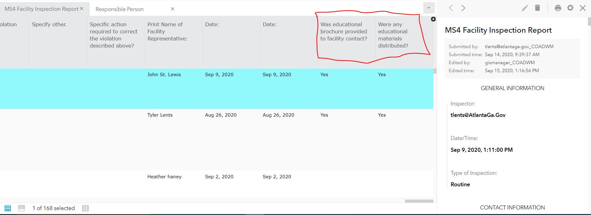

I added 2 new fields and the report is not showing the questions, even though the fields have data.
I deleted the stakeholder view and added the share results settings back. Fields show up in data table and web application.

Did you include the fields in your report template?
Note that your report template includes placeholders that reference data from your survey. For example, ${assetid} will retrieve data from your assetid field and display it in your output report.  Please make sure  your report includes expressions that reference your new fields added.
When you create a sample report template, only fields in the survey are added to the template. Fields that you added into the layer (but not to your survey), need to be added manually into the template.
GISManager4
This is using the default print function.
