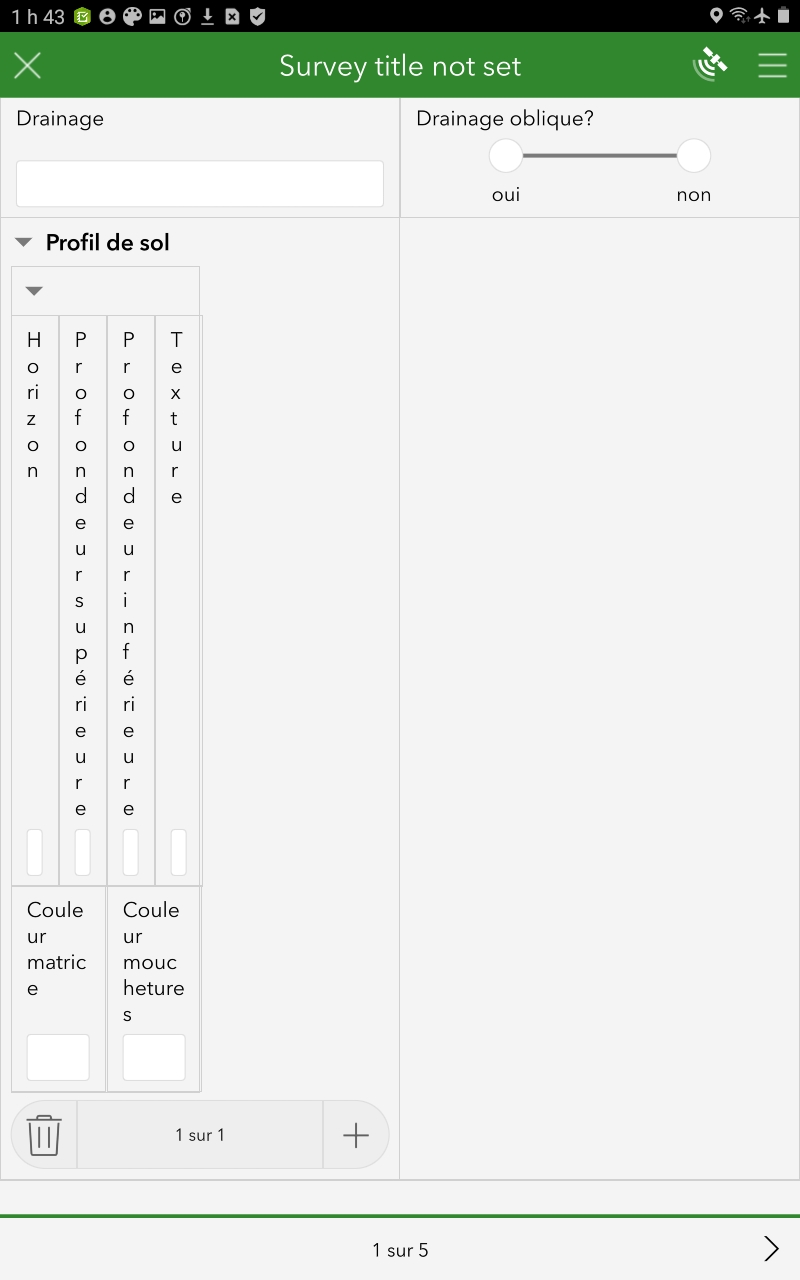

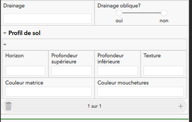

I have used the pages-theme grid in order to set up two or more questions side by side in a repeat.  It has worked out fine in the past.  For some unknown reason, I does not presents it self the same way as it used to on my device (Samsumg tablet), but still shows up ok in the preview on Survey Connect.
Here is the preview on survey connect:
And here is how it turns out on my device:

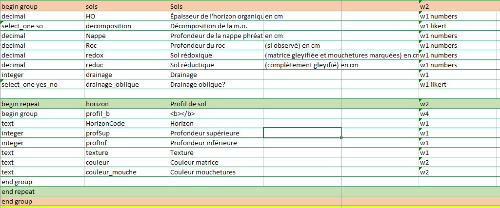

Is there anybody who could help me fix this?  The questions in the repeat are now so small I cannot see the answer in the box.    If it helps, here is the survey Connect forms for those questions:

Hi @ÉmilieBerthiaume,
Based on your screenshot, and the changes in 3.13 to nested groups/repeats and grid theme, see linked post by @DougBrowning which has link to updated blog post on grid theme and groups.
You need to change the begin group at the top to w1, then add a nested group directly below it that is w2, this way all the questions inside it will be side by side as they are all w1. Close that newly added group before the repeat. Then set the repeat to w1, with the group inside it being w4, which is ok, as it created 4 columns in the repeat that the questions are split across. That way the repeat will take up the entire width of the survey and the group it is inside of. Those changes should make it look as it did before.
