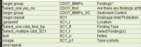

Here is an example of the repeat group with conditionals. Ideally I put this in a nicely formatted table, but I am still just trying to figure out the syntax:
repeat group = sc1
each question within the group is then labeled sc1_l, sc1_f, etc.
${#sc1}${if sc1}Drainage Inlet Protection
  • Location ${sc1_l}
  • Type ${sc1_ft}
  • Findings(s) ${sc1_f}
  • Notes ${sc1_n}
  • Photos ${sc1_p1 | size:375:0:0:600}${/}${/sc1}

BarbaraWebster1
It looks like the error you're seeing is a result of a bug in the feature report export process when exporting geopoints with a bind::esri:fieldType of null that are within repeats.
I've logged this as a bug, but if you are looking for a workaround in the meantime you could remove the null field types from all your geopoints that are within repeats. This will mean that feature layers for these points will be generated, but these can be ignored if they are not needed. Hopefully that helps!
