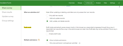

Hi @NataliaKolecka,
Yes, you can enable draft mode for the survey from the Collaborate settings in the Survey123 website. This will apply to the web app when completing the survey in a web browser.

NataliaKolecka
Hi @Anonymous User ,
thanks for the info. I've already found the draft mode option. But it seems to me that the possibility to reopen my not-complete questionnaire only if:
  1. I have not saved it yet, and
  2. I use the same device (computer or mobile)
If the two conditions are not the case, then I can not get back to the survey.
Am I right?
Best,
Natalia
