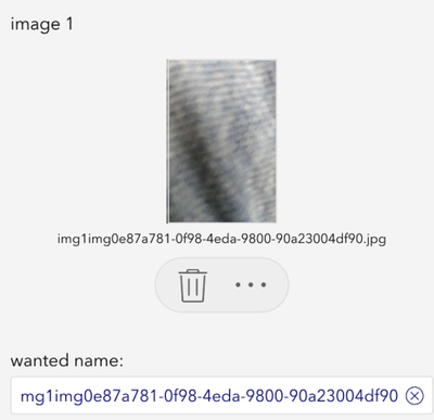

Hello Everyone,
I use the survey123 web app for Vistitor employed photography with cellphones (participats are not logged in). I have the problem that many images have the same name, namely "image.jpg". I would like to rename the images during the participation according to an ID created for each participant and the question answered. There are options to do this, but they seem not to work for me.
I have created an hidden ID field for each participant with uuid() and would like to rename all images of the participant with this ID and the question name in the field bind::esri:parameters with fileName=concat( "ImageQuestionNumberOne",${id}). But this does not work. Depending on the Phone used by the participant, I get image names consisting of a random number, a number with the date or images with the name image.jpg.  I have the same Problem if i only use a string or other ID's to rename it.  Does anyone know what I am doing wrong? An example is added.
Thanks a lot!
IsmaelChivite
Esri Notable Contributor
Hi @frfu794d  The XLSForm you provided works perfectly. I published your survey and tested from a web browser. Photos are renamed according to the expression you set
May be you are not using the latest version of Survey123 Connect to publish your survey? Make sure it is 3.15 or newer.

Hello, I am also having an issue with image file names when accessing the survey through a web or mobile browser. The file names show up as intended in the Survey123 field app and in the Survey123 Connect preview, but will have varying results ("image1.jpg", a series of numbers, etc.) on the mobile browser depending on whether the photo is from the camera or existing library.
Is this a documented issue or am I doing something wrong? Since this survey requires editing existing records and submitting repeats we are limited in options in where data can be submitted.
LMedeirosUI
@Tiff  There's a setting in the web app to make the survey use a particular version of the web app (i.e., the one it was published with or the most current version). It's accessed by going to survey123.arcgis.com, going to the survey, then accessing the survey's settings (far right option in header - see attached picture). What is yours set to?
And as a follow-up after reading some of your other posts, make sure you're using the latest version of Connect to publish the survey. I had published with an older version because I'm on a mac (3.13) and that "broke" the file name feature. When I republished using the current version (3.17), it worked again. I didn't change anything in the XLS form... it just matters what version of Connect you're using to publish the form. This means that it will work in Connect when testing, but won't work when you publish. If you're using a PC, just update Connect and republish. If using a mac, you'll need to use Parallels or find a PC as Esri no longer publishes updates for the Connect app for mac. You will also have to be using current versions of the field app and make sure the setting I mention above (for the web app) uses the latest version.
