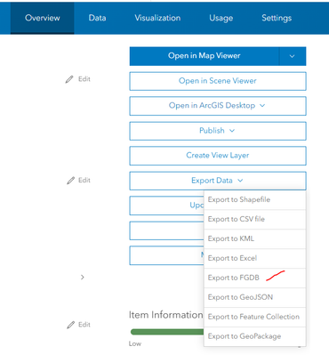

I have carried out a survey between the owner and his land that he can manage. It works well in AGOL. But when I need to preserve the relationship between the features (one has the location of the address and the other is the location of parcels within a repetition) but when exporting to FGDB via AGOL they are lost.
Any idea what may be happening?

Hi, this option does not exist when exporting the Feature layer via AGOL

If you use Export button in the service page it will preserve them.
