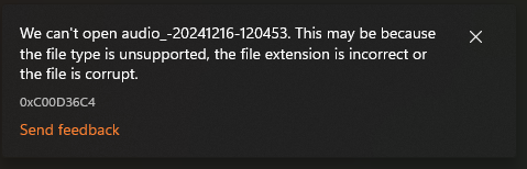

I have a survey that records audio from the mobile device. When downloading the file it is stored as an mp4
The file does not play on any media player that I have tried and I have attempted to change the codec in the XLS form but that didn't work either. Any help would be appreciated

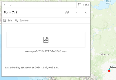

I tried the web map popup, and that method seems to work for me as well:
I'm not sure off-hand exactly which screen you are on there to try that method of downloading.
You've already confirmed that the files do work as intended. Honestly, you may need to open a support case for them to log this as a defect. I would expect "Download" to not corrupt files like that under any circumstances.

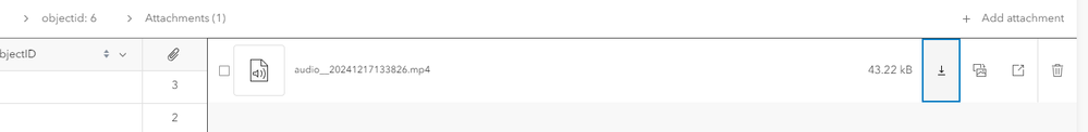

If I access the recording from the feature layer data tab, everything works fine. However, if I download the audio using the map viewer, the recording does not work. I wonder if it is something to do with the download function
