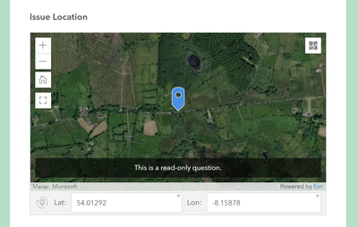

DarraghOSullivan
Hi @Anonymous User
Survey was created on Connect and copy attached (same one as discussed recently re photos). Yes it seems to only be since 3.14 release of web app.
This is an example url:
https://survey123.arcgis.com/share/dea3350f810e453fb4077f778XXXXXXX?center=52.79990420155226,-6.512935538363142&field:Trail_Management_ID=319&field:Trail_ID=40&field:Trail_Issue_ID=21-40-020&field:Trail_Issue_Severity=Significant&field:Trail_Issue_Type=Waymarking%20Issue&field:Trail_Management=County%20Wicklow%20Partnership&field:Trail_Name=Wicklow%20Way
where I use Arcade to provide the x,y from the feature and most of the fields in the survey are pre-populated.

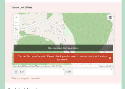

This time I got the below, but in the past there has also been a pop-up asking to allow for location. Choosing no gives this and I guess it remembered from last time.
Sometimes it works ok. This is on a different browser, but seems to depend on choices I previously made in the browser.
Hope that helps - let me know if you need more. Thanks, Darragh
